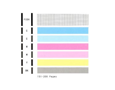

Next, a test of your PIXMA MG5720 should be performed. This will tell us if the printer is working correctly. To do this, please load letter-sized paper in the PIXMA MG5720 and follow these steps:
1. Press the HOME button on your PIXMA MG5720.
2. Use the down arrow key to display SETUP and press the button below SETUP.
3. Select Maintenance and press <OK>.
4. Select Print nozzle check pattern and press <OK>.
5. Select Yes and press <OK>.
The Nozzle Check will print. Please compare your printout to the example that has been posted below. If they differ, please perform a few printhead cleanings.

After a few cleanings, please print another Nozzle Check.
Does the Nozzle Check print correctly?
