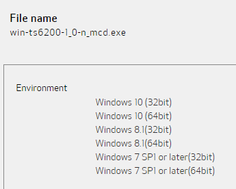

I am unable to connect FROM Corel/Paint Shop Pro 64-bit software to my Canon TS6220 printer but I am able to send a copy of a scanned photo TO my software FROM the printer. Canon support/drivers and downloads does not include an upgrade to 64-bit for my printer. Is there a solution to this problem?

Greetings,
64bit windows drivers for your printer do exist and are avaialble on the support page for your printer.
Support | TS Series - Inkjet | PIXMA TS6220 | Canon USA

Thank you, but it got me no closer to a solution. This was the file I have already dl-ed and installed. I reinstalled it again but still get the error msg from Corel/PSP app that says, "There appears to be no camera, scanner, or other WIA device present. Please check with the manufacturer to see if the hardware you are attempting to access provides a WIA device driver. "
any suggestions?
Thanks.

Hi tct2125,
The installation provide the TWAIN driver for the scanner of your PIXMA TS6220, not the WIA driver.
Please use the IJ Scan Utility to scan with your PIXMA TS6220:
https://ij.manual.canon/ij/webmanual/ScanUtility/W/TS6200%20series/1.1/EN/SU/Top.html
