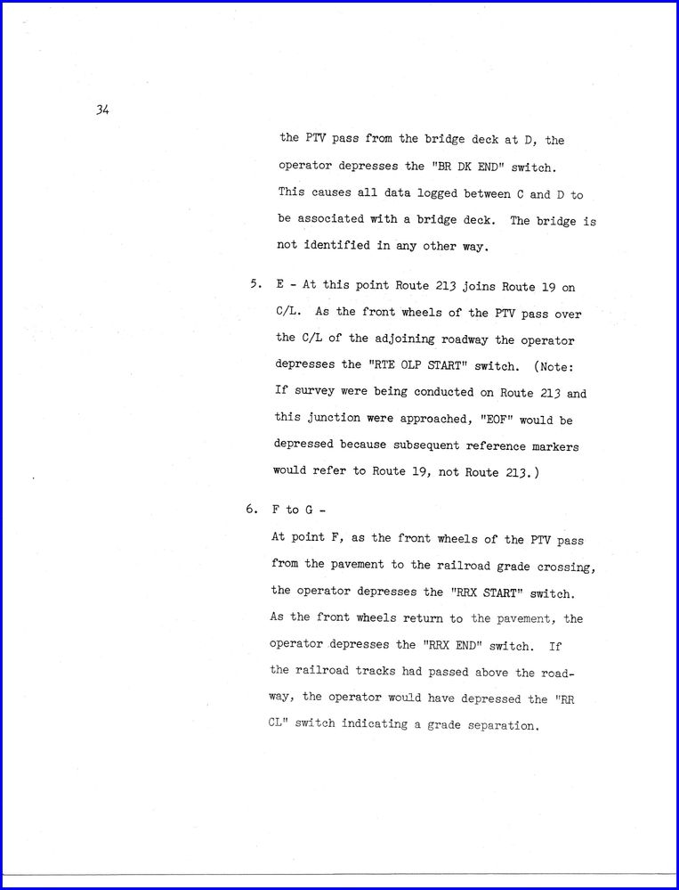

Paper size was set to "Letter". The paper document is letter size. Device manager said Drivers are up to date. I have all my Windows 7 updates. I looked at Canon's website for Driver updates, but all I could find were instructions for downloading the installation files.
I am scanning from the control panel. Here is a jpg of the pdf (I added a 5-pixel wide blue line to each of the 4 sides when I converted the pdf to a jpg):

I just tried scanning again. This time, when I scan in color or B&W, the pdf is 8.5 x 11 inches. There is still a grey line near the bottom. The grey line is straight but it has a slight slant to it. One end of the line is at the bottom of the pdf. I attribute the grey line to perhaps the ADF rollers dis not grab the paper evenly.

I do all my scanning directly from the control panel on my Canon G7020. I noticed when I use the defaults for scanning, the horizontal line appears and the pdf is 8.5" x 11.147". "Original type" says "*Auto scan" (Auto scan is the default). When I go through the menu and change "Original type" to "Document", the line does not appear and the pdf is 8.5" x 11". The documents I'm scanning are on typed paper, 8.5" x 11".
