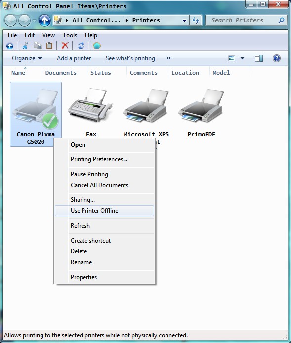

Hi All,
This is nothing like the old days where one could simply plug in a printer and the drivers would self-install! I got a new Pixma G5020 yesterday and am still installing it after 4 or 5 hours of trying. This is on a Win7x64 laptop. Never could connect via USB, haven't tried LAN yet. I now have it where the printer's panel shows connected (Wi-Fi) and ready to print, but the computer's printer icon is grayed out in "control panel | printers" even though it says it's NOT offline. Sending a test page gets stuck in the queue because it states "Canon Pixma G5020 - Offline" even though the drop-down menu's "Use Printer Offline" is unchecked.

When installing a new printer, each failed attempt can add another interface to the list of ports your computer might use to communicate with a printer. Below is an example.
This may affect the computer's ability to correctly communicate with the printer reliably. So you need to pick one type of connection. USB, ethernet or wireless.
If you want the printer to be accessible from any device (including mobile) that connects to your network, using ethernet or wireless is recommended.
While using USB is possible, the system the printer is connected to will always have to be powered on for other devices to be able to find and use the printer.
What your image shows us. The printer has been installed, but the port or interface the computer believes the printer is using for communication has changed or is incorrect. This is why the printer shows as connected to your Wi-Fi on its control panel, but shows as offline on the PC. "Offline" does not have to be checked if the port or method the computer is trying to use to communicate is not valid.
I think using Wi-Fi might be a good option for you as it also cuts down on the wires you need and gives a little more flexibility about where to place the printer. As long as it can receive a good signal from your Wi-Fi, you should be good. Note: the G5020 will only connect to a wireless network broadcasting on 2.4Ghz.
