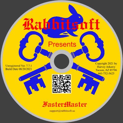

I write and sell computer software for the Security Industry. When I print photographs on my TS8320 printer, the printed images match what I see on my screen. When I use Canon's Image Garden software to print labels on my CD/DVDs the image on the monitor does NOT print properly on the disks.

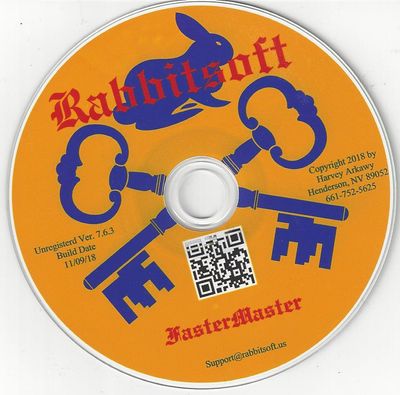

The background is supposed to be yellow but the image printed is orange. I would like to be able to reduce the magenta so the background is yellow. Is there any way to manipulate the colors within either the printer's settings or within the Image Garden software?
The image on the left is what it should look like. The image on the right is how it is printed.

For the heck of it, I downloaded the most current drivers for the printer and installed them. I then downloaded and installed the Canon Easy-PhotoPrint Editor and installed it. After spending about two hours recreating a disk label, I printed a disk only to be disappointed once more. The image's background on the computer is yellow, but the printed image is orange; not quite as orange as the ones from Image Garden but still orange, and YES! I am using Canon original ink.
