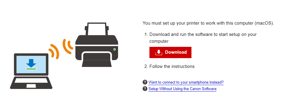

Hi LOFTONGAL,
When you go through the step-by-step process, after hitting next several times, you'll get to a screen that has this:
That page will download the software (driver) required for the printer. It will be a disk image in your download destination (your Downloads or Desktop).
If you need one-on-one help, you must register your printer at canon.us/account first, and then you will see all of your available support options.
