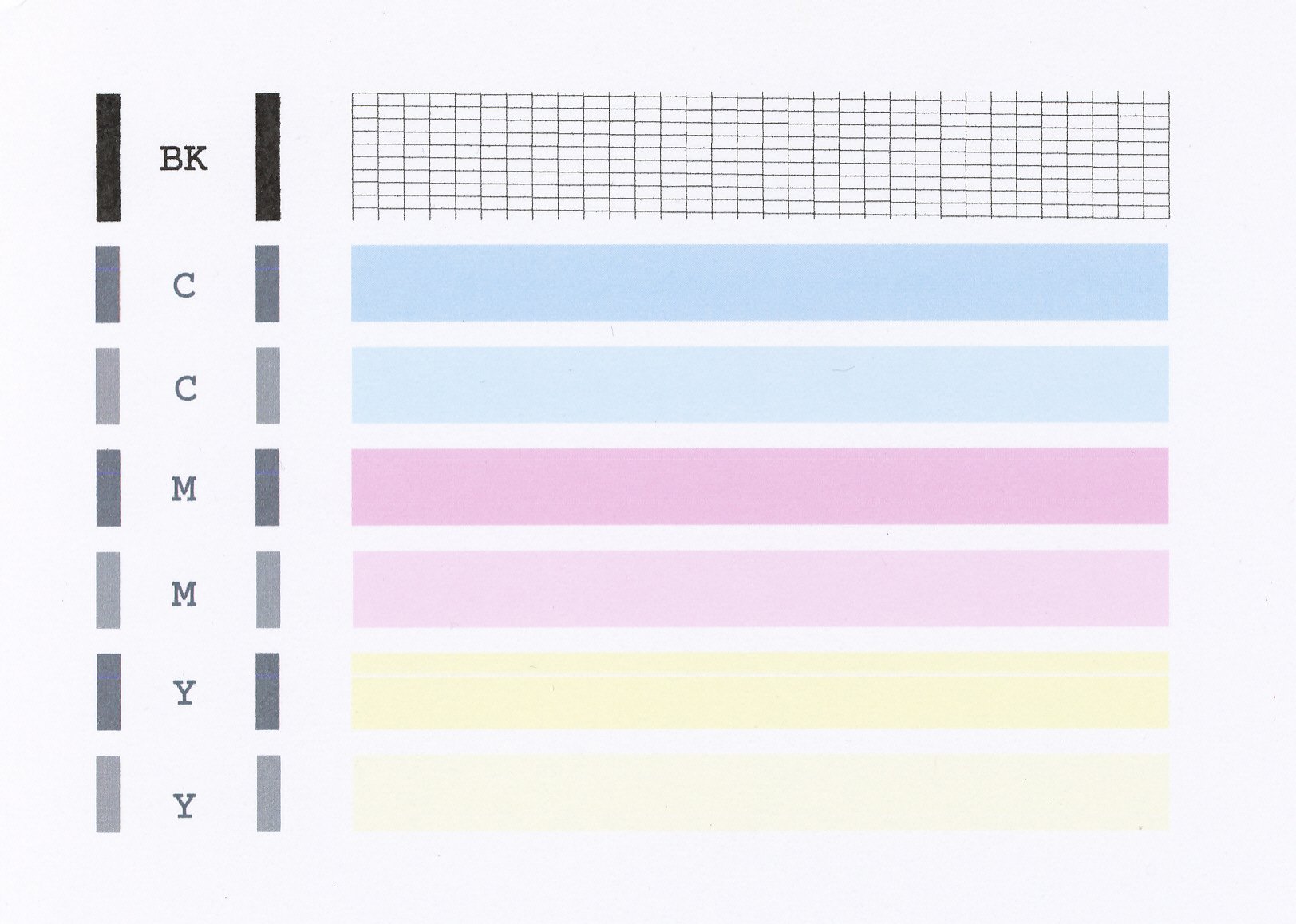

Please make sure the test is printing correctly. Please follow these steps:
1. Load letter-sized, plain paper in the rear Tray.
2. Press the SETUP button.
3. Press the left or right button until [MAINTENANCE] is displayed in the LCD, and then press OK.
4. Press the left or right button until [Nozzle check] is displayed in the LCD, and then press OK. The nozzle check pattern is printed. Please compare your printout to the example that is attached at the bottom of this post.
