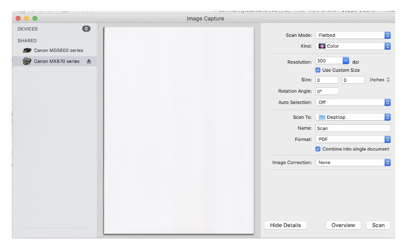

larryis1 - That screen shot you posted is very different than what I see. I do not see any printers listed on the left side and all the stuff on the right side does no appear on my system.
I am curious, are your printers connected to the computer via USB cables? My printer is on our newtork, no USB cable. I wonder if that is a problem. I hope not, I don't want to go that route.

Hi Hector, Both of our printers are connected wirelessly to our Netgear Router. Both of our Apple iMac computers and other computing devices are all hooked up to the same router either through Ethernet or wireless.
Suggestion... Go to your Mac OS System Preferences, Printers, and delete your printer, and reinstall the printer. If you are using your wireless network router, and the printer is set to wireless connection, Mac OS should see and recognize the printer over the network. If you have already done this, forgive me for mentioning these steps. Good luck.

My MG5725 appears as a Device under the shared section on the left pane of Image Capture as the prior post showed. It currently is showing the contents of the document I have on the scanner.
