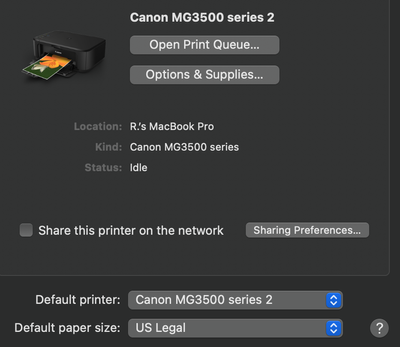

Probably a long-winded way of addressing the issue, but any help from Canon/the community would help, I just want to print properly! Again, I'm using a MacBook Pro, 13-inch, 2020 version - running on macOS Big Sur, Version 11.2.3, I'm using the provided USB cord attached to the printer with a USB C to USB adapter I already had - I'll attach the image of the printer info from my Printers & Scanners tab of my System Preferences.

When you added the printer in System Preferences-Printers & Scanners did you wait till the Canon IJ Series driver showed up? You don't want the AirPrint version of the driver.
I noticed that the top of your screenshot shows 3500 and the bottom 2500.

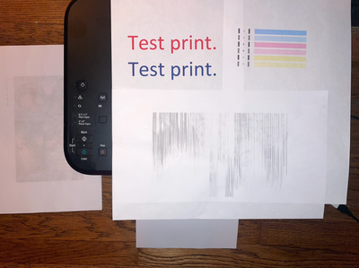

So, I think I may have fixed one issue, I believe it is no longer the AirPrint version, but now when I do press print, it processes, but no ink appears on the printed pages. I'll attach the updated picture of the printer in Printers & Scanners, as well as the ink levels now indicated.
Is there any reason why the printed pages would be blank, while the standard print tests show up with B/W and Color normally?
Sorry, new update.
So, I managed to get it to print, somewhat. Despite what the ink levels indicate, and my re-inserting/checking the ink cartridges, black ink barely registers - when I used red and dark blue text on Word to print, they seemed to show up. I'm wondering if there are any specific ink cartridges to be used for this specific printer, the Canon Pixma 3500, or if it's possible the ones provided with this printer are outdated/old/faulty in some way? Again, color seems to register fairly well, but black hardly at all, despite what the printer Supply Levels show. The seller didn't indicate any of this to me personally, and vouched both inks were supplied/the printer was functioning normally, so just want to make sure it's an ink issue as opposed to a printing/printer issue.

It looks like your black cartridge is not printing when you run a nozzle check. You could try some cleaning attempts and maybe get a new black cartridge.

Are there any specific cleaning attempts you would recommend? I tried to de-dust around the cartridges and the slots they fit into, but pretty rudimentary.
