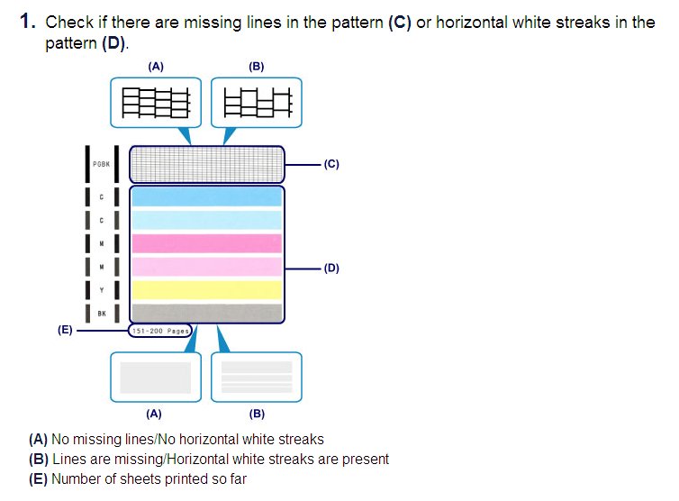

Let's try a test of your PIXMA MG5520 to make sure that it is working correctly:
1. On your PIXMA MG5520, please select SETUP from the HOME screen.
2. Select Maintenance and press <OK>.
3. Press <OK> on Print nozzle check pattern.
4. Press <OK> on Yes.
The Nozzle Check will print. Please compare your printout to the example that has been attached to the bottom of this post.
Does the Nozzle Check print correctly?
If not, it is recommended that you contact our support group using the following link:
http://Canon.us/ContactLI
01-31-2017 01:59 PM
hi Patrick
I did the check.
The grid for PGBK prints out. It's clear. The lines are not as "off" as the pictures you posted.
Should the lines be trailing off and look mismatched?? Eg the line that starts at the top left is joining up to the 2nd notch on the far right and a row has appeared gradually along the tope. The same for the bottom.
I've tried to upload a picture to send to you but the uplood tool won't let me upload a word doc with an image in it or a photo....suggestions on this too so that I can actually show you?
