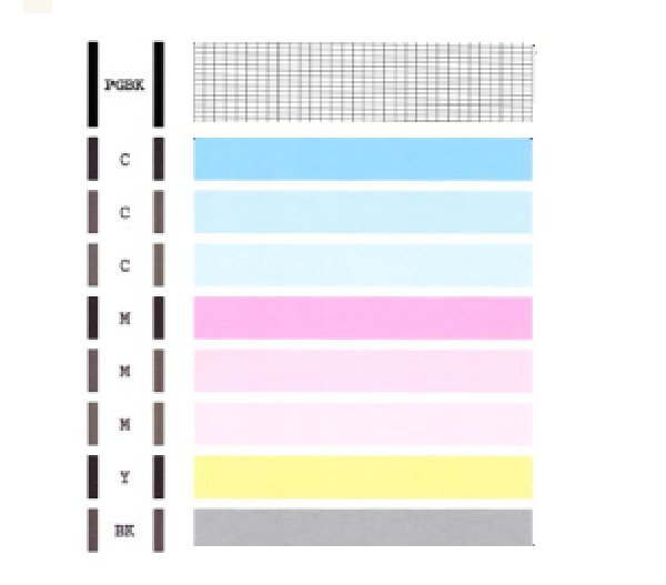

Next, a test of the printer should be performed. This will tell us if the printer is working correctly. To do this, please load letter-sized paper in the PIXMA MG5420 and follow these steps:
1. Press <HOME>.
2. Rotate the menu to Maintenance and press <OK>.
3. Press <OK> on Print nozzle check pattern.
4. Press <OK> on Yes.
The Nozzle Check will print. Please compare your printout to the example that has been attached to the bottom of this post. If they differ, please perform a few printhead cleanings.

After a few cleanings, please print another Nozzle Check.
Does the Nozzle Check print correctly?  If not, please contact our support group using the following link:

  • Does your nozzle check resemble the one above?
I look forward to your reply.
I get a blank page when I try to photocopy in black or color.  I get a blank page when I run a nozzle check.
