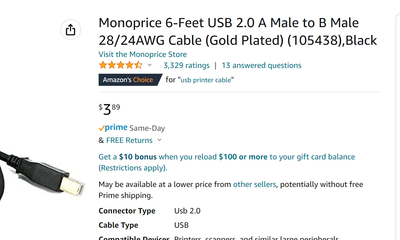

Greetings,
Yes. Has to be done via USB cable. Since a USB cable is consider an accessory, its not a reimburseable item. Same way a USB stick is considered an accessory.
Hopefully something like this won't present too much hardship:
