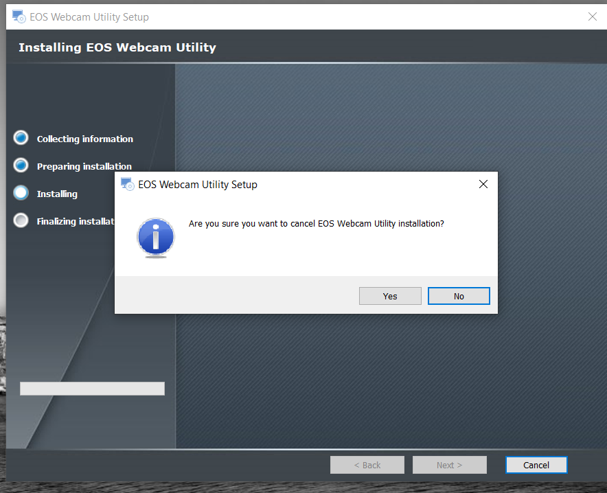

erikno
I have downloaded the software but every time I get to the point of "install" and push that button, I then get the question "are you sure you want to cancel EOS Webcam Utility installation?". Either yes or no, I get thrown out of the process.. Any fix for this? I am running windows 10 (64)
NPirollo
Not applicable
try a different browser. Chrome?
erikno
I use chrome as default, and the screen that comes up is outside the chrome browser

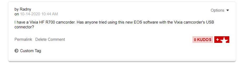

Radny
Not applicable
I have a Vixia HF R700 camcorder. Has anyone tried using this new EOS software with the Vixia camcorder's USB connector?
NatalyaP
Product Expert
Product Expert
Hello, Radny
Unfortuntely, the VIXIA HF R700 will not work with the EOS Webcam Utility. Only tested cameras by Canon USA will work with the EOS Webcam Utility and you may click on the following link to view a list of compatible Canon cameras: https://www.usa.canon.com/internet/portal/us/home/support/self-help-center/eos-webcam-utility/

I can't even install the EOS Webcam Utility on Windows. Downloading and unzipping, running setup.exe and running as administrator, during the install it says "EOS Webcam Utility setup ended prematurely because of an error. Your system has not been modified. To install this program at a later time, please run the installation again." Any advice on installing the software?
