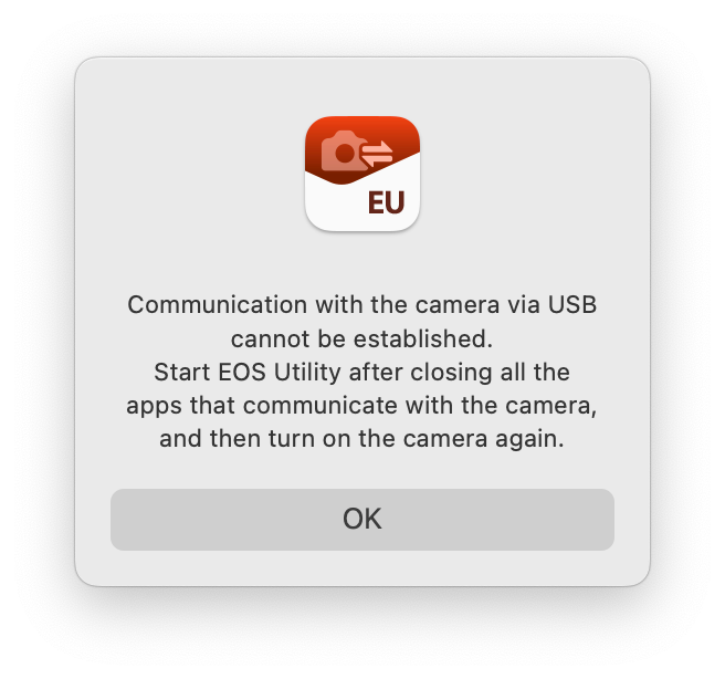

I've been seeing that connection modal for many months now sometimes it still works despite the message.

I have tried what has been listed here, and still does not work. I have removed the software, reinstalled older version, newer, latest version. It still gives me the same error noted above.
Any other ideas on how to fix this problem?

I have uninstalled the utility and used another program to scrub any lingering files off the computer. I used the link provided and changed the 7D mark II software. Installed the 3.18.41 for macOS, connected the USB to the camera, turned it on, and again got the same error.
"Communication with the camera via USB cannot be established. Start EOS Utility after closing all the apps that communicate with the camera, and then turn on the camera again."
I'm unsure what apps it thinks are trying to communicate with the camera, as I only have the EOS open and the browser I am using to write this on the taskbar.
I appreciate your help with this. What do I do next?

Bought the CANON IFC-500 U II cable, still same problem as before. It is telling me the same error as before: "Communication with the camera via USB cannot be established. Start EOS Utility after closing all the apps that communicate with the camera, and then turn on the camera again."
What now?

I have to manually start EOS 3, and once I turn on the camera, get the error, if I knew what other programs are trying to use it, I could try to turn them off. Just gets frustrating, to have to manually move files from the card to the computer...
