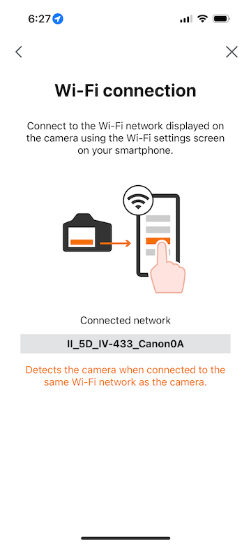

There may be an issue with the app (bug) as I just tried with version 3.1.1 with my EOS 5D IV and iPhone 14 Pro. At first, I had thought it was an issue tith ethe Smartphone name (accessed via the three horizontal line menu in the app under App Settings | Name. But even after editing the name to match the name as shown in the camera, I can never get past the registration screen:
Tapping on "X" here returns the main app screen, and it never registers the new camera. Later I will try completely resetting all the WiFi settings in the camera and creating a brand new WiFi network.
I have not used this app ever since I updated our WiFi network to use a mesh network. Previously, I had manually configured 2.4GHz and 5GHz networks and would connect the camera always to the 2.4GHz one.
On the camera though, when looking at its settings, it does claim it's connected to the network and I can also connect my iPhone to the camera's network.

Well that was quick; got it working.
On my EOS 5D IV, I went to Menu | Wrench #4 | Communication Settings | Built-in wireless settings | WiFi Function and deleted "Set 1" (which had contained older connection information).
I then re-created "Set 1" using the "Easy Connection" method and followed the on-screen instructions. Basically:
