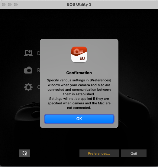

Hi and many thanks. I did as you suggested and got the two below screen shots. I have closed all apps and attempted to connect the R6 but no success. The "Blue" dialogue will apply after the R6 is connected.Screenshot 2025-01-04 at 14.40.36.pngScreenshot 2025-01-04 at 14.41.00.png
Are you using EOSU version 3.18.5? Do you have any background applications running that would download images (like Dropbox?). You said you used Image Capture. Did you terminate operation? I tried on my MacBook and if IC was running EOSU3 wouldn't connect (but I didn't get the notice you did.).
