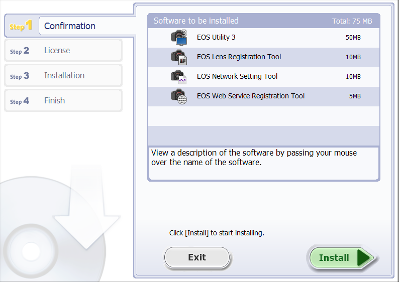

I uninstalled what I had before and downloaded the installer from the linked page. Still, no Utility 2. I'm running Windows 10.

I'm running Windows 10. I installed the latest version of EOS Utility from the official page. Utility 3 came with it and it's the latest version as well. Utility 2 doesn't even appear on the list of the installer.

You do not want to download the latest version of the EOSU3 installer if you want to get EOSU2.
You need to download version 3.13.20 or earlier. That version will install EOSU3 along with EOSU2. The Canon support site used to explain that but the new format has removed a lot of explanatory material in the apparent interest of uniformity.
