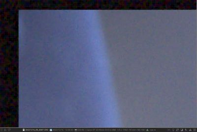

The quality loss you get is in the deep shadows. Here the optical black area brightened. Your software normally crop out this. I think this was brightened 4-5 stops.
Thank you! I'm looking at them in Capture One. I might compare PS or Adobe Camera Raw.
