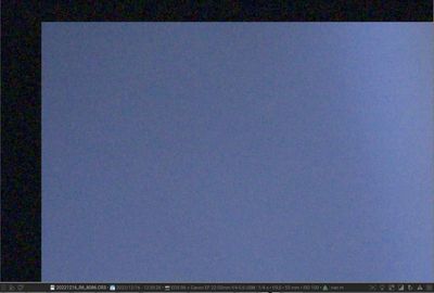

Any software using Libraw should be able.
Latest Adobe Camera Raw and Lightroom should also be able to open C-RAW.
The quality loss you get is in the deep shadows. Here the optical black area brightened. Your software normally crop out this. I think this was brightened 4-5 stops.
