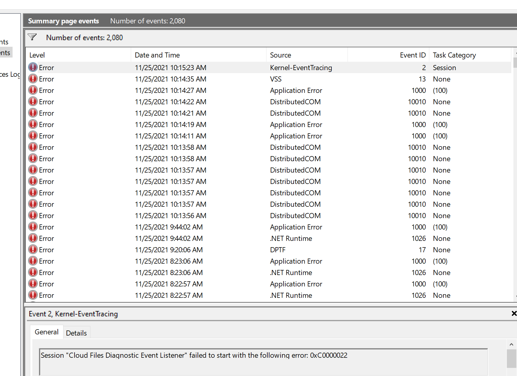

Ok. I found the event viewer. I see where a it lists the problem with the application. Do not under it though. I have Uninstaller and reinstalled with Canon tech rep and it still did not work

Error listed / Event Viewer.  If you double click on the entry, a window will open with the copy option.
Now paste that for us to review.

Double click on one of the Application error entries.  That will open the dialog I was referecing above.  Does it indicate a problem with DPP?  Confirm that for me.

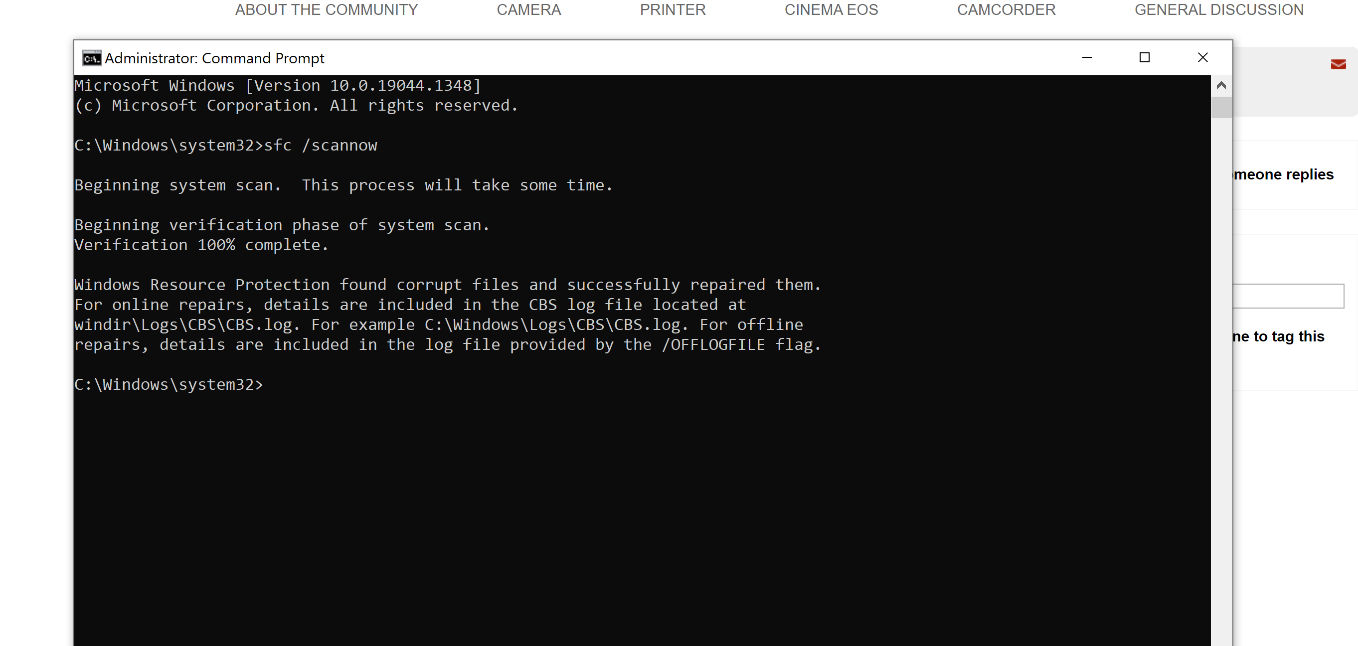

Start menu type cmd
This time however, select Run As Administrator
At the prompt type >sfc /scannow
(note there is a space between sfc and the forward slash)
Press enter
Let this run.  It should complete in under 3 min.
Let me know the result.
"Windows did not detect any integrity violations"
"Windows found corrupt files and repaired them successfully"
Windows found corrupt files and could not repair them"
If corrupt files were found and repaired succesfully, close the command prompt window.  Restart your system and test opening DPP for me.

UGH!!!! No it didn't open
