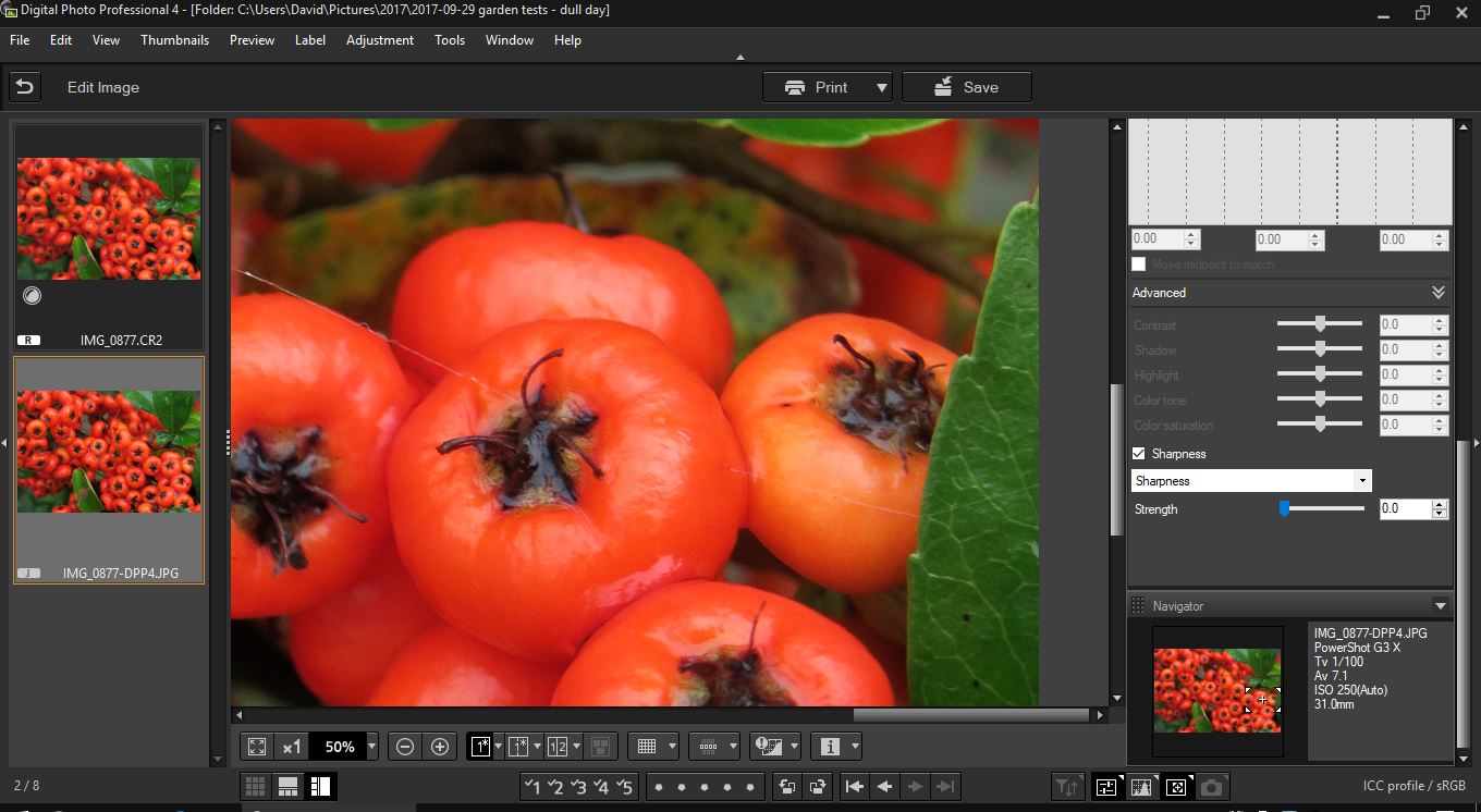

I can see the difference between raws and jpgs even when looking at a jpg processed using DPP4. Please see the screen grabs below.
EDIT: you may have to save or open the images in a new window to see the difference.
RAW
JPG converted from the above RAW
I am not going to see much of difference from screen shots, but i will take your word for it.  Be sure to always be cognizant of MFD, minimum focusing distances, especially at wide apertures and relatively slow shutter speeds.
