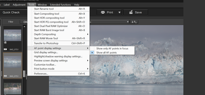

Greetings,
This is available in DPP if that works for you. From the Tools menu:
Please let me know if I've mis-understood your request?
04-10-2024 08:34 AM
Much appreciation - looks like that is going to work. Thanks again.
