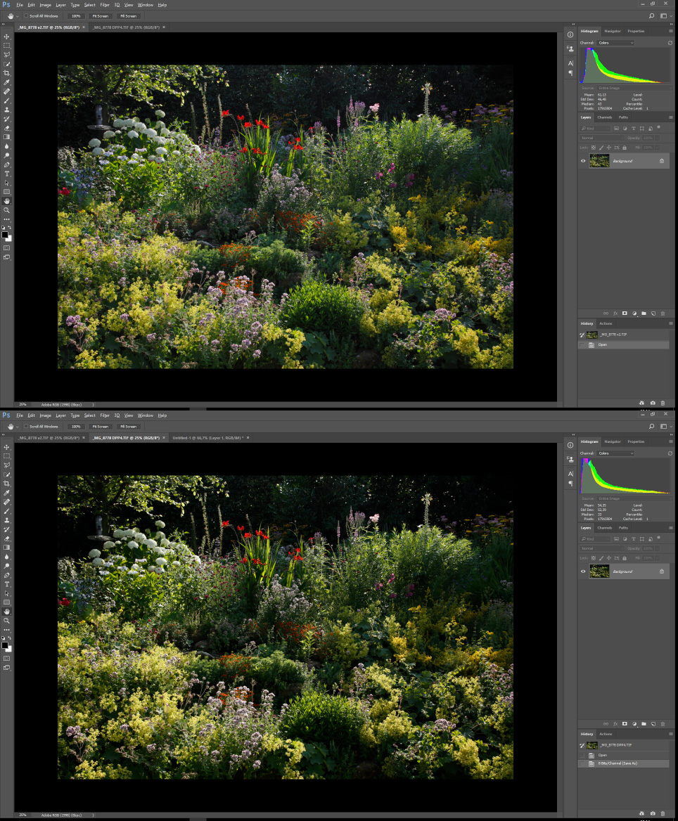

Attached are two screenshots of the DPP2/3 (top) and the DPP4 (bottom) version, as seen in Photoshop.
Note how the DPP4 version has lost all detail in the shadow areas.
Settings where the same for both exports. (defaults)
Also note the histogram that also shows that the actual file is different and it is not my color settings.

And as mentioned before, the exports for sRGB and ARGB have different results when viewing in Photoshop, or any other ARGB supported viewer (as can be seen in my start post).
When I convert an ARGB file to sRGB in Photoshop, the photo does not change visually, but the histogram does, as it should.
Thus, it is a bug in DPP.
Exports for ARGB and sRGB should look identical, and since DPP4 they don't.
ARGB, as well as Wide Gamut RGB and other profiles from DPP4 have clipped shadows, while sRGB does not.

You are missing the part where I write that in PHOTOSHOP, ARGB en sRGB look identical. So even if it would look different in DPP, it should still look identical in Photoshop. So DPP export wrongly.
I do understand that when your system- and screen profile is ARGB the sRGB image would be missing some depth, but when already viewing as sRGb the difference is not visible. Try for yourself....
IT IS A BUG introduced in DPP4. I have used DPP 3,2 and probably 1 since 2005. And those versions did not have this problem. Thanks 😉
