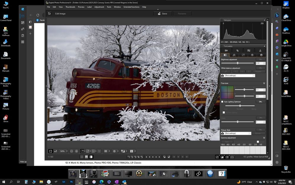

You don't have to print, just "Convert & Save" the new image:
Original image showing crop areaOriginal image showing crop areaConvert & Save command windowConvert & Save command windowNew cropped imageNew cropped image
