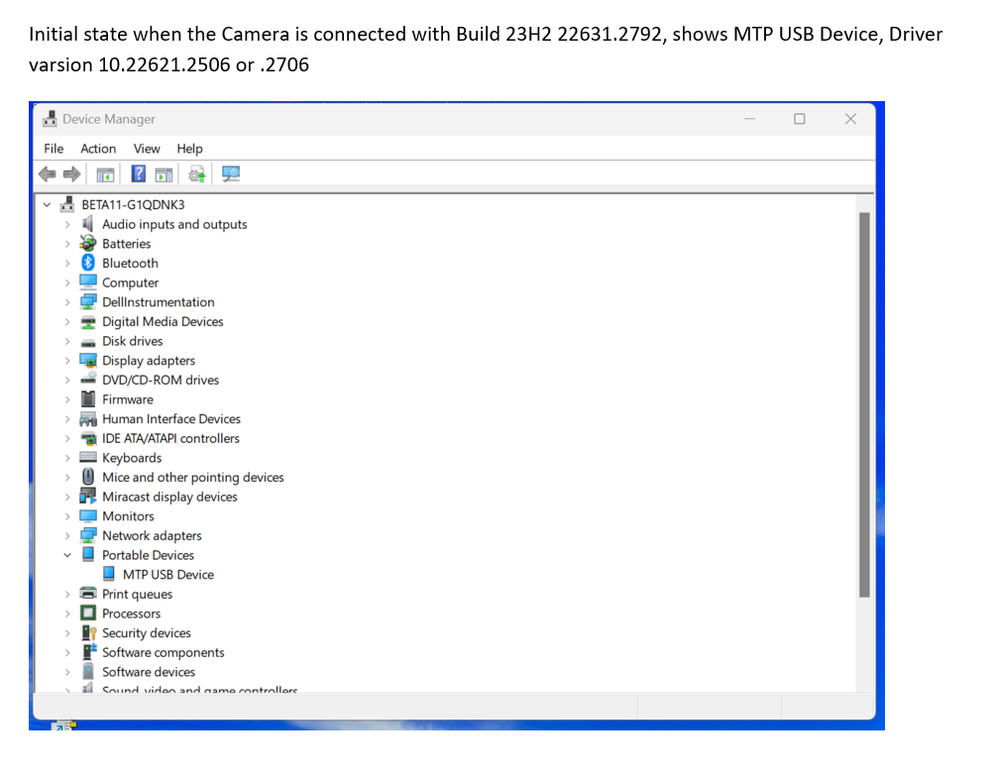

I verified that is still work fine with Windows 11 Build 22H2 22621.1702, but no longer works with Build 23H2 22631.2792. Look like Microsoft did some drivers updates and the Canon Camera no longer works correctly.
The working Driver is version of the driver is 10.0.22621.1, the ones that fail are 10.0.22621.2506 and 10.0.22621.2706 or even higher versions.

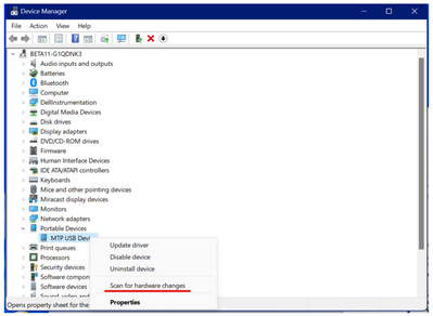

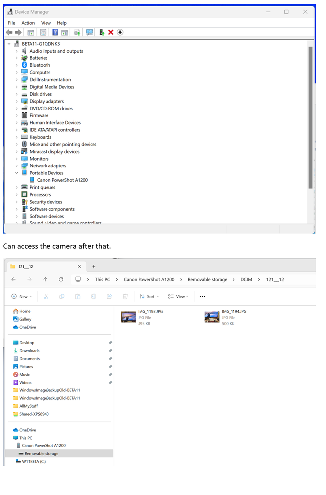

When the Camera is first connected it shows up as an MTP USB Device and it does not work until a "Scan for hardware changes" is run from Device manager. At that point the driver shows up correctly as Canon PowerShot A1200 and the camera can be accessed.

Try scan for hardware changes in Device manager Portable Devices on MTP USB Device, it may take more than one attempt but eventually it updates the driver, and you can see the camera folder in file explorer.
It is a workaround till Canon and Microsoft sort out this messy bug.

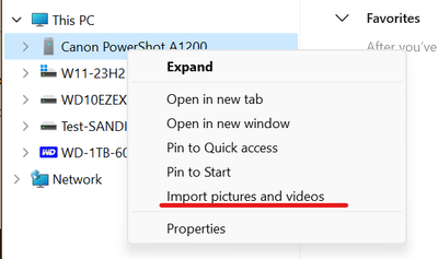

There is a workaround once you've gotten the camera to show up in File Explorer. Right click on the camera name and one of the drop down options is Import pictures and videos. You can then set up the options to duplicate what CameraWindow did. A couple of more steps from what CameraWindow did automatically like automatically detect the camera, but close.

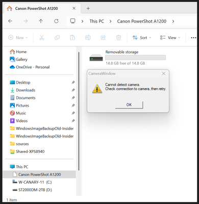

01-16-2024 06:27 PM - edited 01-17-2024 06:25 PM
@rstevens15,
The Import pictures and videos on the right click works, as it always did, but that is not the issue. The problem is getting the recent Windows 11 to recognize the Camera.

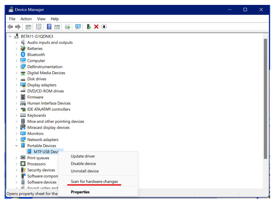

The only workaround for that I have seen working is by opening device manager and hit "Scan for hardware changes" a couple of times then open file explorer and see if the camera finally shows up. Only then you can right click and select "Import pictures and videos". 😎
As for the CameraWindow application, I downloaded from the link provided, I'm installing it, we'll see if it helps at all. 😉
And it fails to recognize the camera as you can see on the 4th shot below. 🤬
