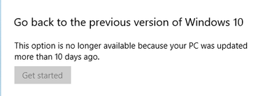

Hi Rick,
Thank you for the reply. Unfortunately, it turns out that I missed the ten-day portal. It was only after I wrote the message above that I investigated if it was possible to reverse the 10 to 11 process. Looked like an easy solution, but by then, going through the steps you have included here, I got the message that it was not possible for this PC. In that Win 11 has only recently come out, I would expect Canon will probably have an EOS Utility compatible with the Win 11 OS within a few months. In the meantime, I'll just use my old Win 7 PC. Hopefully this exchange will help others.
