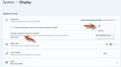

Your image will go through various changes as DPP adds its adjustments and that may be what you are seeing. I've been using it [DPP] for many years and have never noticed my image changing once DPP is finished running its adjustments, even in Windows 11.
However, if it is indeed Windows 11, and it very well could be, please look at your display settings: Type "settings" in the search bar then select "system". Now select "Display" and click the chevron on the far right of the "Brightness" slider. This will give you what's shown in my attachment.
I use a laptop so if you have a desktop, that pulldown menu may look different. But you still should be able to make the proper adjustments.
I hope this helps!
Newton

There is still a possibility that Windows is messing with the brightness if that feature isn't turned off. The OP just needs to check to see. It just takes a minute.
