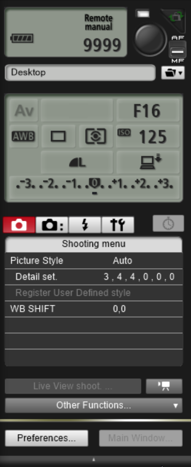

You have to be in another focus mode, besides Tracking/Face Detection before you will get the zoom feature in EOSU. Press the "Q" button while in Live View and select "Spot". I think you can use the pull-down and select "FlexZone - Single" in EOSU, but I didn't try that, so I just set it on the camera while I was doing remote shooting with the EOSU.
The images are just for reference so you can see the the difference in the appearance of the focus point/box.
