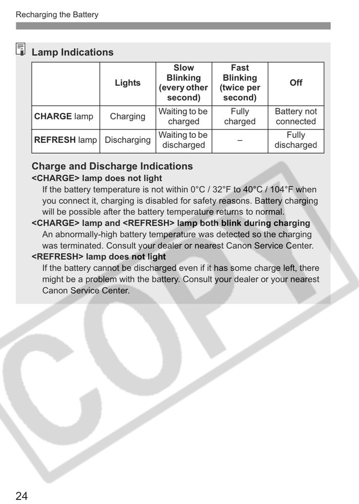

I have had my 1DsMKII for ever. Now when I plug the batteries into the NC-E2 Charger only the "Refresh" yellow lamp comes on , sometimes flashing, sometimes on solid, and the batteries do NOT charge.
Am I missing something?
"Charge" light never comes on.
Solved! Go to Solution.
09-10-2022 03:08 PM
The Refresh cycle takes about 8-9 hours. No charging will take place until the Refresh cycle has completed.
Have you waited 8-9 hours for the cycle the complete?

09-11-2022 10:19 AM
YES I have and the "Charge" light never appears. 2 batteries connected.
What is so unusual is that the copy of the Instruction Manual you post above is NOT included in original "Owners Manual"

09-11-2022 01:33 PM
Gentlemen!!!
I am a total IDIOT!!!!!!
The "Power" light was lit but the charger was NOT plugged in!!!!!!!!!!!
Feel free to call me that!!!
Thanks!
Dan
