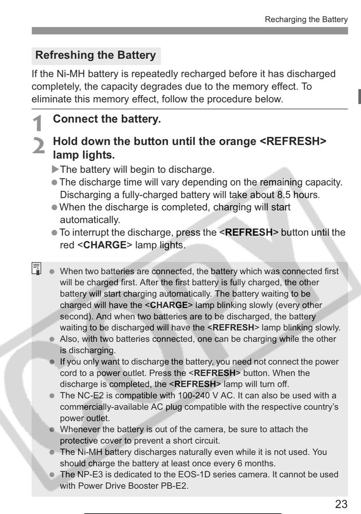

The Refresh cycle takes about 8-9 hours. No charging will take place until the Refresh cycle has completed.
Have you waited 8-9 hours for the cycle the complete? 42EE6DA1-1BB0-4875-BFE8-97121C4FA5F3.jpeg

YES I have and the "Charge" light never appears. 2 batteries connected.
What is so unusual is that the copy of the Instruction Manual you post above is NOT included in original "Owners Manual"

09-11-2022 01:33 PM
Gentlemen!!!
I am a total IDIOT!!!!!!
The "Power" light was lit but the charger was NOT plugged in!!!!!!!!!!!
Feel free to call me that!!!
Thanks!
