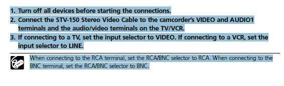

I have purchased a Free World 7" monitor to use with the XL2 camera and I cannot seem to be able to get a signal out to the monitor. I am using the RCA Video out to mini jack which goes into the monitor but all I get is "No Signal." I feel that I am missing somethning here such as the camera cannot send a signal out to the monitor by default, If this is the case then how would the camera send out a signal to TV's back in the day?
I am new to this camera.
Thank you.
10-10-2015 11:06 PM
Below is what I found in the XL2 manual. I hope it helps.
