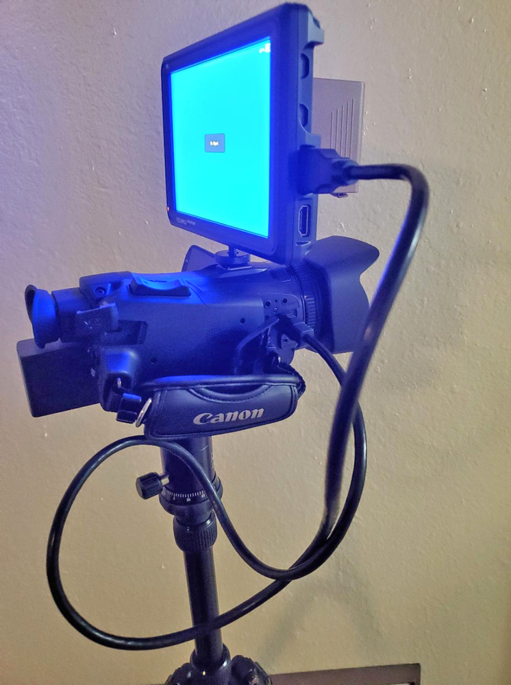

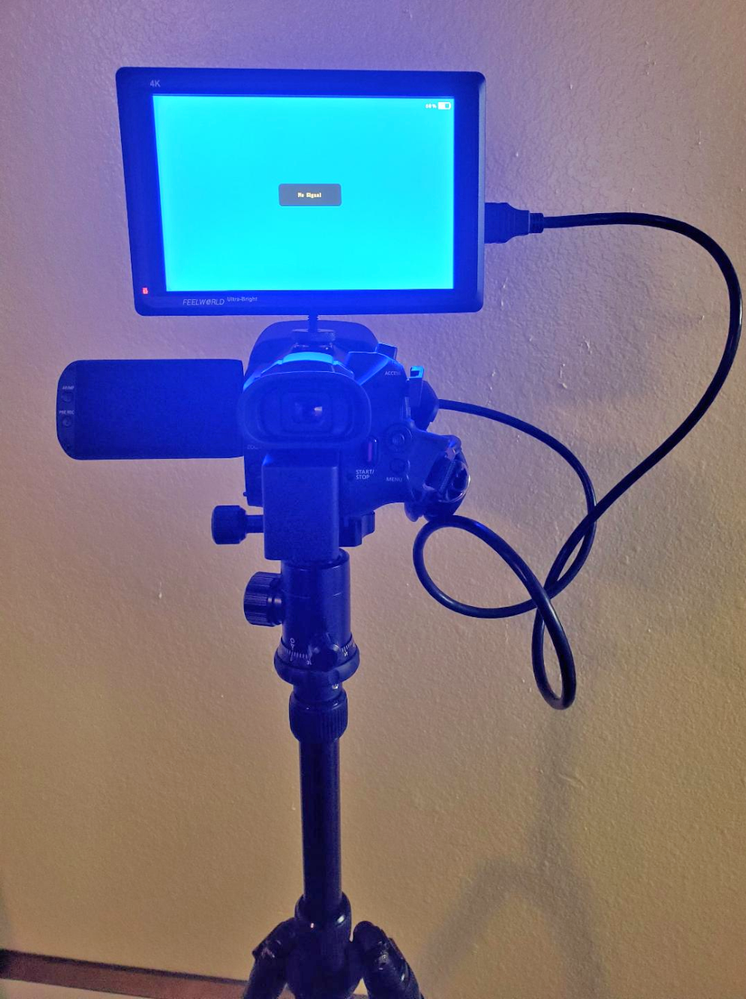

I bought the Canon VIXIA HF G70 camcorder because I was sure that I could use the FeelWorld FW279S field monitor with it. But every time after I connect the HDMI cable from FeelWorld field monitor to my new Canon VIXIA HF G70 camcorder, I keep getting a "No Signal" error on the FeelWorld field monitor. This occurs whether or not I have the camcorder turned on and while the FeelWorld field monitor is powered up. Please advise.

Thanks for your reply. Not quite, on my FeelWorld FW279S field monitor I have it plugged into the HDMI-Out. But then the cable is plugged into my Canon camcorder's HDMI Out. I don't see an HDMI In on my Canon VIXIA HF G70 camcorder. The only other slot that I see is a DC In. Please let me know if there is an HDMI In on my Canon VIXIA HF G70 camcorder and if so, if that is where I should plug it into. There is an HDMI-In on my FeelWorld field monitor, but I don't have any cable plugged into that.

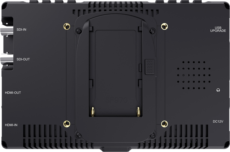

Looking at your pics you have the HDMI cable plugged into the wrong socket on the monitor. You need to plug it in to the bottom one which is labelled HDMI In.
In the pic you have the cable plugged into the monitor's HDMI OUT.
