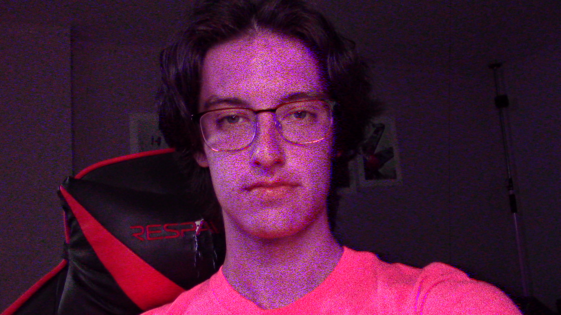

For the past 5 months, I've been using a Canon Vixia HF R800 as a webcam using an Elgato Cam Link. It's been working great, but randomly today when I turned it on, the colors are all purple, and there are lines going down the frame. I don't know what's wrong, I didn't do anything that caused this as far as I can tell. Any help is greatly appreciated.

Hi there JoshhyBoy,
To see if its a problem with the camera or not, does the same thing show up on your camcorder LCD screen when its not connected to anything?
‎05-13-2020 07:04 PM
Yeah, it's always there no matter what

Try doing tests where you disconnect any accessories from the camera then remove the battery and memory card for about 20 minutes. Then try recording new clips on a new memory card and play them back on camera.
If those clips look OK, then try doing more livestreaming tests. If your clips still look distorted, then I suggest that you email us at hdvideo@cits.canon.com with details about your camera, your date of purchase, and the state from where you are sending the camera, and we'll walk you through the repair process.

I have the same problem and have followed all the recommended solutions, but to no avail. The LCD still has a purplish hue (and lines). This is a back-up live stream camera for our church. Has anyone found a solution?
‎08-30-2021 09:52 PM
A replacement camera ended up being our solution.
