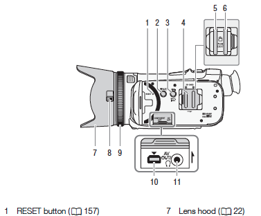

Have you looked at the Zoom options starting on page 52 of the User Manual?
Look on page 157 under "Abnormal characters apear..." for instructions on how to do a factory reset.
You can look on page 14 for the location of the Reset button (swing the LCD screen out).

Thanks for the reply I did try that it reset everything but the camera is still zooming all the way in. I did call technical support. Very frustrating I was just told to ship it in and they would give me a repair estimate.
