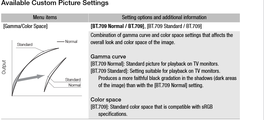

Oh here's something. I checked the HF-G50 online manual and CP gives you two BT.709 gamma curve options - Normal (the default for CP1) and Standard. Quite likely then, the gamma curve in 'Looks' (with CP turned off) is in fact Standard. If so, it would then be just a matter of editing the CP1 preset (as described in the manual) and changing the gamma curve from Normal to Standard.

That looks right to me, Inapickle. Will be interested to see if that resolves the issue.

@Mark35mmF2 wrote:That looks right to me, Inapickle. Will be interested to see if that resolves the issue.
I think that is the case. On the HF-G and XA series camcorders that have more than one 'look' (my HF-G40 included) the default 'look' is always referred to as 'Standard'.
