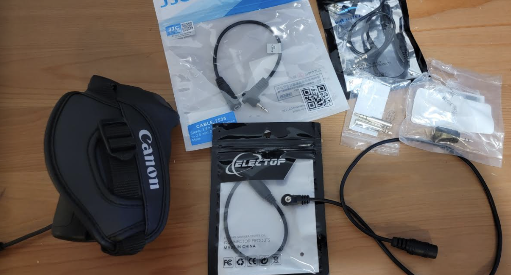

I'm close to getting the GR-V1 grip to work with Canon C70 and wanted to share some findings and get some advice!
I pre-ordered the C70 with the intent of using on my shoulder on occasion and having on-grip controls. It would be a massive flaw if this camera were unable to do so, as that means it simply can't compete as a documentary camera.
I'd love anyone's assistance helping me find a cable/adapter to work from the 3.5mm Canon C handgrips to the 2.5mm remote terminal. I'm fairly certain this will work based on the below findings.
FS5 and FS7 Grips
Connected via LANC cable, both of these handles are recognized by the camera and the joystick functions with up/down/left/right and select. The record and other buttons do not work, which is expected because they are mapped differently. But it shows that the remote link's capable of receiving multiple signals.
C100/C300 Grips
Do not work, because audio cables don't provide either enough power or consistent signal. (Or maybe I just can't plug them in all the way)
Cameo Gear Grip
This thing is ugly and buttons are a bit flimsy but it works via hirose to lanc cable. I've tested this as well. Iris and button mapping work. These are somewhat hard to find as they are entering EOL.
GR-V1
This, of course is the natural choice to use. I've purchased it and am looking to connect it to the C70. Any help in selecting a cable (or cable+adapter) to make this happen?!
Attached are a few photos
The Canon 3.5mm grip connection on the GR-V1 (C-series grip). The C70 only has 2.5mm remote in.
This cameo gear grip works but it's really not intuitive and no longer supported by manufacturer.
(Yes, excuse the tripod ball.)
Lastly here are some of the cables I have tried. I was advised to use 3.5mm to 2.5mm audio adapters but they either do not fir or do not work with the GR-V1
Any thoughts on where to find a cable or combination of cables to get the GR-V1 grip working on c70? Thanks all!

Did you ever find out if the GR-V1 could work with the C70 if a properly fitting 3.5mm --> 2.5mm adapter could allow the grip to plug into the Remote terminal on the C70? For reference I have the Wooden Camera extension extension cable which allows you to relocate the grip and works fine with cameras like the C200 and C300II. Just wasn't sure if the language between the GR-V1 and the Remote terminal is fundamentally different. Thanks for your efforts to solve this maddening issue.
02-20-2023 05:45 AM
The LANC for C200 involves a (vital) 4'th connection not by the 3-part pin out of the 3.5 jack but via a 'socket-connection' circumfering the very base of the 3.5 jack.
Hence a std. 3.5 -> 2.5 adapter will not work for full compatibility w. Canon GR-V1 Grip.

I didn’t. Canon grips aren’t compatible with the C70 in any circumstance. Canon could likely manufacture something, but that would be uncrippling a product, which isn’t their thing. Sony grips work with limitations though. However, this camera is a terrible form factor to shoulder mount. I borrowed an FS7 grip to try shoulder mounting and it sucked. If you want to shoulder mount a sub-$10K camera, you’re better off switching to Sony.
