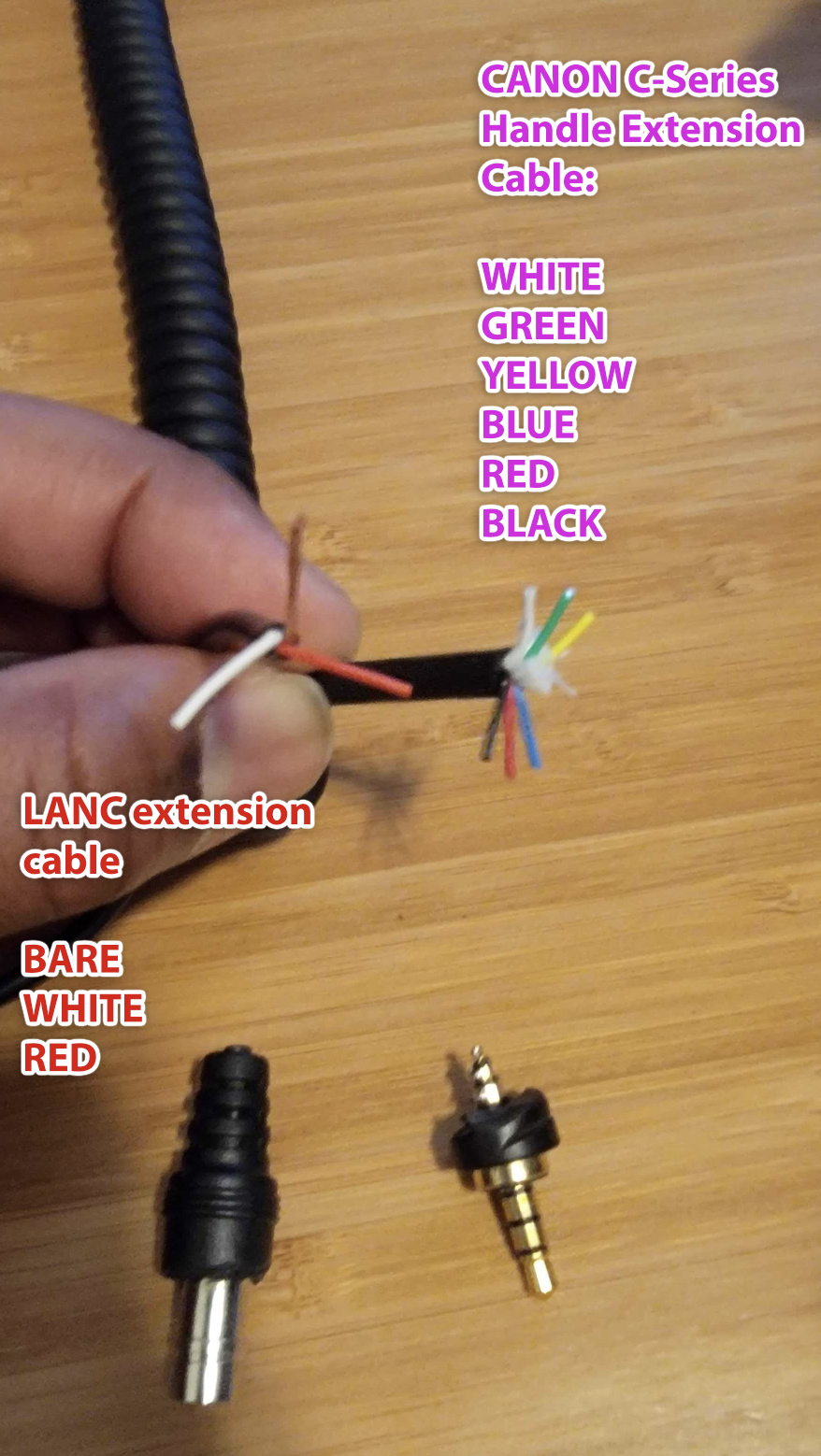

Update:
I'm still trying to get the GR-V1 (or any canon grip) to work with the C70. This is a tremendous oversight on Canon's part imo.
After cutting a Canon grip extension, it appears the Canon cable has 6 cables, a standard lanc has 3. I've ordered a 2.5mm TRRS cable which may work, and will also test all combinations of connecting it with a 3-cable lanc.
If anyone has any knowledge on the below, do let me know which might connect to which to at least get partial functionality out of this grip.
