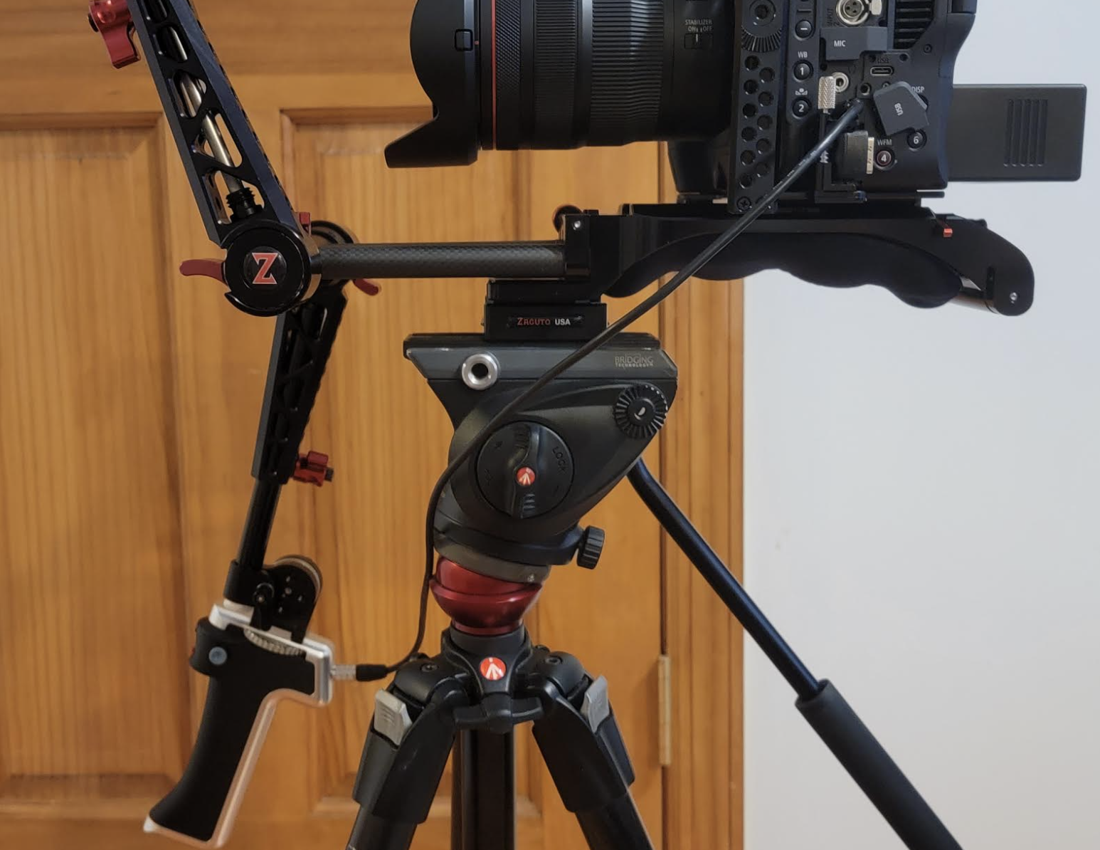

I'm close to getting the GR-V1 grip to work with Canon C70 and wanted to share some findings and get some advice!
I pre-ordered the C70 with the intent of using on my shoulder on occasion and having on-grip controls. It would be a massive flaw if this camera were unable to do so, as that means it simply can't compete as a documentary camera.
I'd love anyone's assistance helping me find a cable/adapter to work from the 3.5mm Canon C handgrips to the 2.5mm remote terminal. I'm fairly certain this will work based on the below findings.

Cameo Gear Grip
This thing is ugly and buttons are a bit flimsy but it works via hirose to lanc cable. I've tested this as well. Iris and button mapping work. These are somewhat hard to find as they are entering EOL.

Attached are a few photos
The Canon 3.5mm grip connection on the GR-V1 (C-series grip). The C70 only has 2.5mm remote in.
This cameo gear grip works but it's really not intuitive and no longer supported by manufacturer.
(Yes, excuse the tripod ball.)
Lastly here are some of the cables I have tried. I was advised to use 3.5mm to 2.5mm audio adapters but they either do not fir or do not work with the GR-V1
Any thoughts on where to find a cable or combination of cables to get the GR-V1 grip working on c70? Thanks all!

The LANC for C200 involves a (vital) 4'th connection not by the 3-part pin out of the 3.5 jack but via a 'socket-connection' circumfering the very base of the 3.5 jack.
Hence a std. 3.5 -> 2.5 adapter will not work for full compatibility w. Canon GR-V1 Grip.

I didn’t. Canon grips aren’t compatible with the C70 in any circumstance. Canon could likely manufacture something, but that would be uncrippling a product, which isn’t their thing. Sony grips work with limitations though. However, this camera is a terrible form factor to shoulder mount. I borrowed an FS7 grip to try shoulder mounting and it sucked. If you want to shoulder mount a sub-$10K camera, you’re better off switching to Sony.
