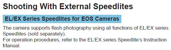

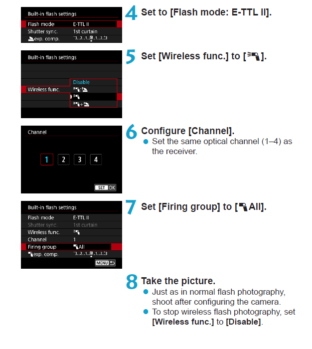

The following images are from the EOS 90D manual and says/suggests it does.

You go ahead and think that.
This screen lets you set radio wireless when you have an external flash that supports it. The camera itself can only do optical wireless flash with the pop-up flash.
09-30-2019 08:17 PM
Radio wireless flash is not accomplished via WIFI.
