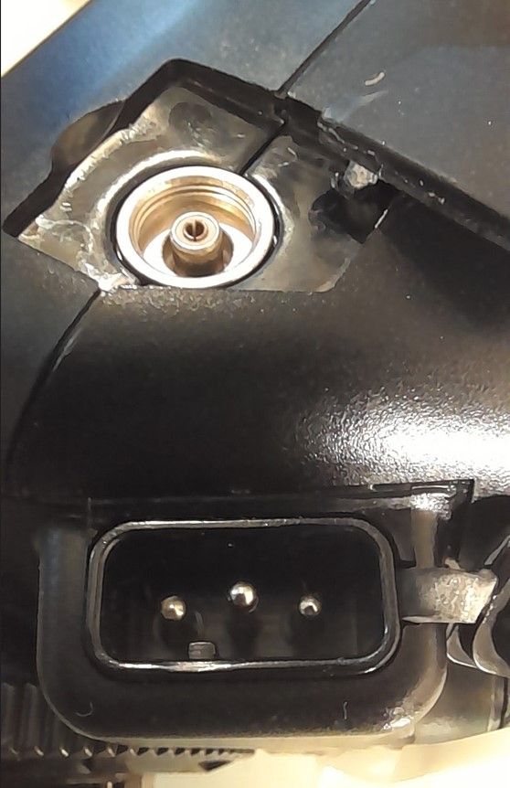

Thank you Mike. Do you have a direct link to the firmware update? I could not find it anywhere.
Also, I can't see any way to connect the flash to a usb cable. There is only a 3 pin charging port and a circular flash firing port.
Are you using the YN14EX II or the earlier Mark 1? I have the Mark 1. I suspect only the Mark 2 can get a firmware upgrade and has the extra usb port.
So I guess I will have to use a work around by dialling in exposure compensation or get a new flash.
Thank you for all your help and support.
mikemathmiller
I have the Yongnuo YN600EX-RT II and thought there would be the same process to update your firmware as mine. I looked online at some photos but couldn't see a USB port.  There is a possible cover near the flash hot shoe on some models.  Turn your flash upside down and look for it.  The firmware should be in the vicinity of this link, but I couldn't find yours.
The company is pretty good about answering questions via email.  Try emailing a question to [email protected].  Keep your questions simple and brief because they are not native speakers of English.
[Commercial link removed per forum guidelines and replaced with the page's firmware link.]
Thanks again Mike for your help. The e mail and links are very useful.  I checked and there is no data port anywhere on this flash. I did find a YouTube video with a hack about using the Yongnuo (YN622N-TX) transmitter to connect a flash to a PC wirelessly:  https://www.youtube.com/watch?v=r46LEAuP9og . However,  as the YN14EX is an older flash, I don't believe there is a firmware update available. I will double check with Yongnuo support.
