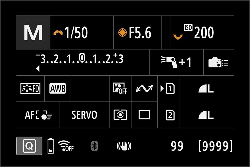

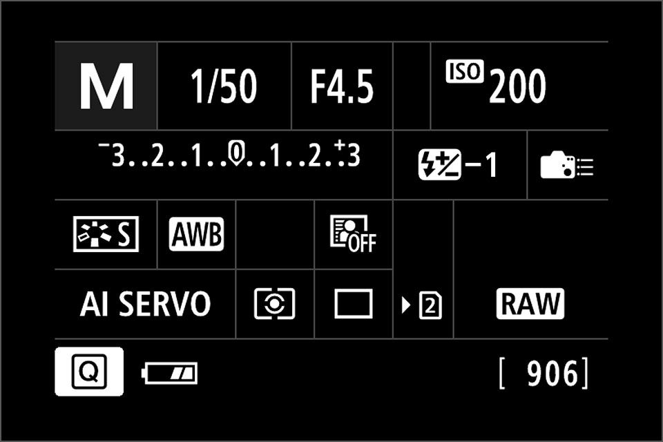

My EOS 7D Mark II has a button on the camera to allow flash exposure compensation to be set on the body, same for many other DSLR. If no compensation is set on the Speedlite or transmitter on the hotshoe, the camera set value prevails. If a Speedlite or transmitter on the hotshoe has compensation set on there it overrides the camera set value.
Mirrorless cameras - just checked EOS R6 / R10 / R6 Mark II, when you set flash exposure compensation via the camera menu of a connected transmitter or Speedlite the change is also shown on the device, but the camera uses the old camera settings icon on the INFO display. If you then change the compensation on the Speedlite or transmitter it takes priority and overrides the camera set value, and the camera info display is different too.
My approach to this is the same as it has been since before mirrorless. I set flash compensation on the transmitter or Speedlite on the hotshoe always. It is more logical to my brain to change the compensation there, and that is the one that has the priority.
This is the info screen from the EOS 7D Mark II, which has a button to change flash compensation on the camera.
Camera set flash compensationCamera set flash compensationTransmitter set compensationTransmitter set compensationCompensation changes the transmitter not the cameraCompensation changes the transmitter not the camera
Then this is the EOS R6 Mark II
Compensation set on camera with control ring on lensCompensation set on camera with control ring on lensCompensation set on Speedlite / transmitterCompensation set on Speedlite / transmitter
