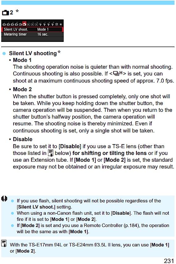

12-13-2022 08:00 PM - edited 12-13-2022 08:04 PM
Are you using LiveView? If so, you must go into the menu and disable Silent LiveView shooting. 3rd party, non-ETTL flash units and triggers (with only one pin) will not fire in LiveView if Silent mode 1 or mode 2 is enabled.
If you are not shooting in LiveView, then there must be a problem with your Neewer trigger.
