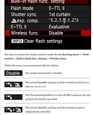

02-07-2016 12:18 PM
John,
Thanks for your reply, and please see above the extract from the web page you kindly forwarded.
I have set the 7D to the middle setting "Only the external speedlite will affect exposure, the pop up flash will only fire a pre flash". So I think what I want it to do is achievable somehow.

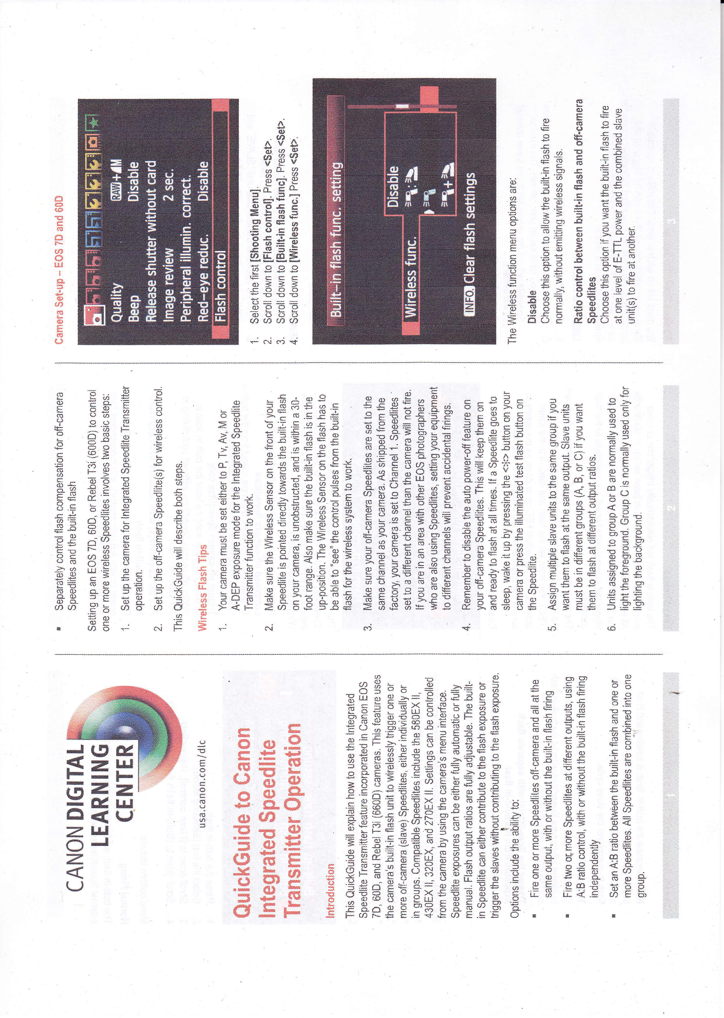

02-21-2016 10:44 AM
Further to previous correspondenses, please see attached guide from Canon which clearly states that "The built-in speedlite can either contribute to the flash exposure or trigger the slaves without contributing to the flash exposure."
I've followed all the instructions but cannot stop the built-in flash from 'contributing'.
I've seen other Canon websites stating the same thing so there must be a way.
Can anyone help?
