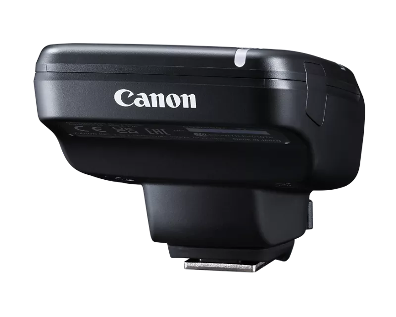

I'm currently still performing experiments when I can.  I have six 600 EX-RT units (original version) along with the original version 1 of the ST-E3-RT.  I have not updated firmware at all on any of this equipment over the years.
The first time I witnessed the constant link dropping was a couple months ago.  All times prior (granted, I only do flash work a few times a year) worked a-ok.   I was outdoors in my backyard at the time.  Four flash units were in a deep 43" umbrella and my camera was within 8 feet of them.   Constant drops of at least 3 of the four units.  Had to cycle the power on flashes as well as the ST-E3-RT.  Could maybe take a couple shots and then no more until I cycled power again.

Yes this started happening somewhat last season, and now this year the RT wireless system barely works or sometimes at some event/venue spaces will not work at all. I have been using the RT flashes since around 2013, and they used to work solid and worry free. It must be cellular 5G rollout or newer WI-Fi technology? There was a wedding I did last year in Hartford, CT, Bond Ballroom which is an event space on the top floor of a high-rise, and i’m pretty sure there were cellular antennas on the roof. My flashes were going crazy with green link LED and the flash ready icon on each channel pulsing on and off. First time I ever saw that, or had a major reliability issue with my 600-ex-rt flashes. Fast forward now and I plunked down $3,000 on 3 of the new EL-1 and they just don’t work wirelessly.
