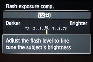

You can never "soften" the flash intensity, you can only adjust the flash exposure using "Flash Exposure Compensation". (FEC)
The 1D Mk III had an exposure scale on the right side of the viewfinder, but setting FEC is also very easy on the 6D.
FEC is adjustable both on the camera and on the flash. The flash FEC will over-ride the camera FEC so make sure both are at "0 FEC", and then adjust one as needed.
Since you are using YN-622C triggers, I would always stick to using just the 6D's flash menu to set FEC.
