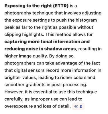

“ Not buying that for a second. There are way too many variables to make a statement like that. Wide aperture lenses, exposure mode how much contrast is on the scene or how. “
It seems to be baked into the cameras. You can see signs of it in histograms. There’s even a name for it. ETTR.
