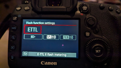

Is the camera’s flash menu displaying the picture below. If so that would be normal since it’s an older speedlite. E-TTL II is a camera body update not a flash update. So no matter which flash you use you’ll be using E-TTL II. Older speedlites cannot be controlled from the camera menu. Usually functions not available from the camera menu. Are grayed out or missing completely which is normal. The only setting that can be controlled from the camera menu with the 430EX (Classic) is Flash Exposure Compensation (FEC). Older speedlites do not support 2 way communication from the camera menu. That feature was added in 2007 with the 580EX II. II in this context has nothing to do with E-TTL II. It’s just the 2nd version of the Flash released.

Indeed, with the 430EX II and 580EX II the "ETTL-II" that option could be highlighted in my RP... I did't know about the two way communication lack of the older Speedlites...
Out of curiosity I tried the 430EX on the EOS 6D and it shows the same behaviour (greyed out)... and, yes... with the 430EX II and 580EX II the E-TTL option in the camera menù became active.
