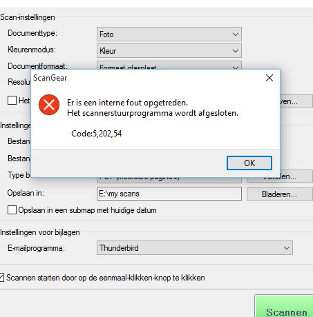

good news for this ongoing issue: i have updated to windows10 and the scanner is usable again.  the error still pops up and the scan is aborted but the computer doesnt freeze up anymore and you can retry the scan! it works! (and windows 10 is actually pretty ok)  so finally i can scan again!  my administartion will be so happy with all the new freshly scanned receipts!  very lame from canon that they have not taken this issue serious and have not made some effort to solve the issue.

I swapped yesterday to Win 10 (feels faster so far), but the LiDE problem persists. To me it must be related to this PC, which is just 18 mths old with Intel 7i and a brand new HD plus both 3.0  and 2.0 ports of which the both used to cooperate with the scanner until suddenly refused.
LiDE 210 works perfectly with our two laptops on Vista and Win 7 with the original software installed. I tested earlier both the original and the latest driver version on 8.1 with the same disappointment. The scanner starts with handshakes( those sounds), which when it worked used to be too long ones, but now only one and clicking on scanning thereafter you hear a starting sound, which abruptly cuts off. There after the following error messages are found and trouble shooting gives the following indications. This b....rd plays games with me and I am not clever enough to get why.

oh no, the problem is back:(  i think i give up on this scanner..
