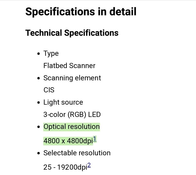

1) In the specification from Canon it states:
OPTICAL resolution 4800 × 4800 dpi (in accordance with the image). In the U Scan Utility, maximum is only 600 dpi. In ScanGear the maximum is only 1200 dpi found.
How do you access and scan in the OPTICAL resolution 4800 x 4800 dpi?
2) Moreover, in the specification from Canon it also states:
Selectable resolution 19200 dpi. How do you utilize and access 19200 dpi?

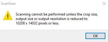

Then I received, in spite of the fact that I am an advanced Digital Photographer, the following ambiguous message. Does anyone have an idea how to interpret this message and how to act?
Appreciate your cooperation

I wondering about the two latest pictures: How should they interpreted and operated?

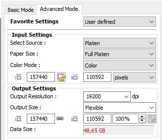

However, what does the following mean in practice. That is what I wish to verify and how to enter:

Hi AlexKnox,
When the data size exceeds a certain size, the value appears in red. In that case, a warning message appears when you click Scan. It is recommended that you adjust the settings to reduce Data Size. To continue, scan in whole image view. (ScanGear > Advanced Mode Tab > Output Settings)
In your example, the resulting scan would be over 48 gigabytes, which is larger than ScanGear allows.
