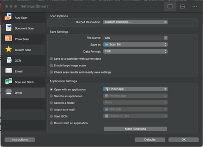

I have the "Driver" configuration set to 600dpi and TIFF output. When I begin a scan and change the dpi in the Overview dialog to 4,800dpi, it seems to complete the scan but then presents an error that the scan failed because it was not set to a valid output (either jpg or tif). But of course, it WAS set to "tif" output. This seems to be a bug.
Here is the Settings panel for Driver

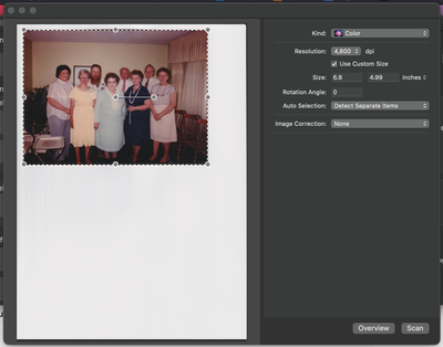

I began the scan and changed the dpi in the Overview dialog to 4,800dpi...

You have the application set to open in Finder
What happens if you use Image Capture instead.
10-31-2023 04:25 PM
I changed it from open in Finder to open in Photoshop. Tried it first with a very small scan and it worked fine. But when I tried to scan a 5x7 color photograph at 4,800dpi it produced the same error. So it seems pretty obvious the Canoscan app is not handling large files well.
